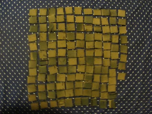

                          I found an old cotton web belt @ Goodwill last night for 49 cents. I will take pictures of the process and post them in the near future.

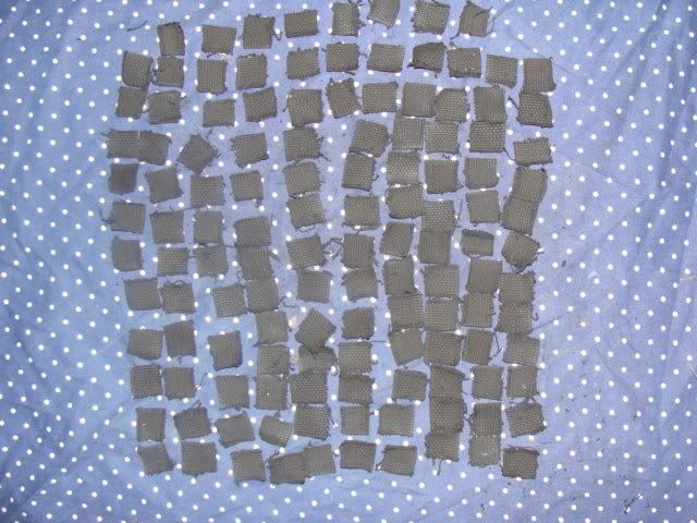

                              My 49 cent belt netted me 128 pieces of char cloth.
                              Before
                              After
