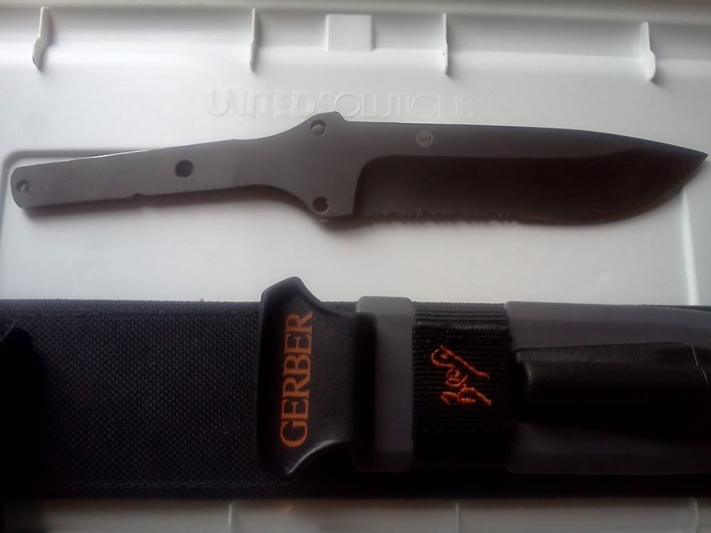

[IMG][/IMG]I got this knife cheap and have been stumped as to what to do for the handle. Any ideas. I want it original, comfortable, rugged and good looking.
Well I would assume you would want a wood handle unless you own specialty tools for metal or polymer working. What I think looks best in a wood handle knife would be to use tight fitting metal pins if you can find them. It depends how much work, time, and money you are willing to spend. So the question is what would you like it to look like?
I am not sure what I'm wanting it to look like yet. I've made a couple different types of micarta slabs, didn't like em, I only have oak scale blanks for wood. I did like the original scales but not sure if I could reproduce them with fiberglass or not.
build a sacrificial mold and cast polymer with rubber inserts.
get some plastic modeling clay...and build the handle you want....spray with wax.....encase in silicone rubber.....bust off modelers clay....use a resin/ catalyst to fill...
Good idea.... now what are you talking about.LOL
I've been looking online about resin casting , it may be the way I go.
