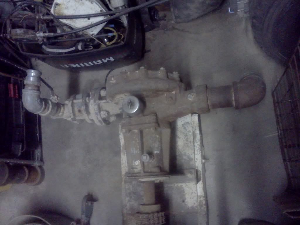

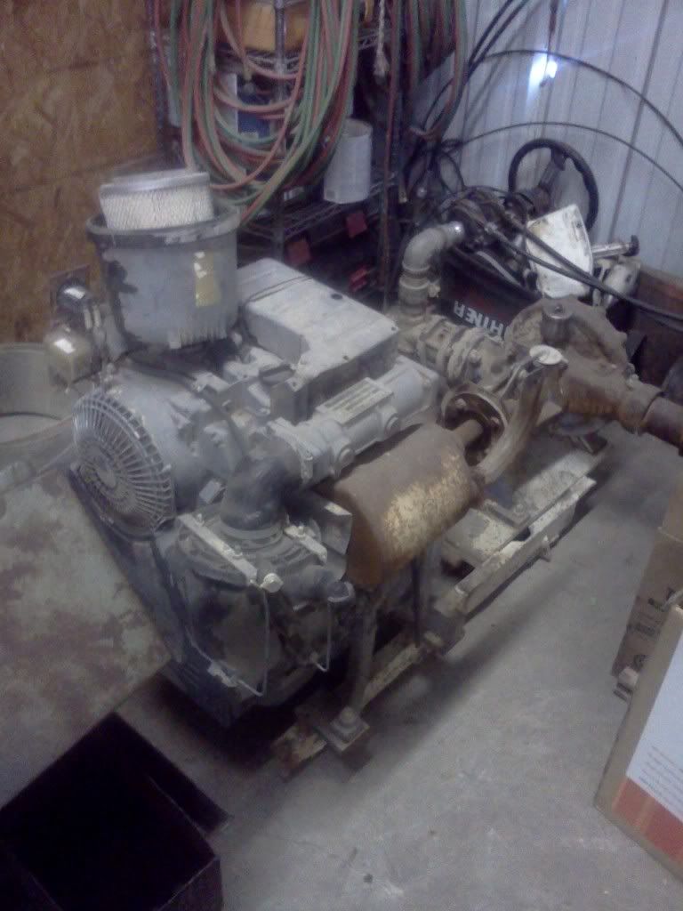

                            Maybe something like this would work. It pumped waters about 2 miles at 90 to 120 psi
                            Here is the powerplant.
                              I believe he's wanting it to be hydro powered.. it should be doable somehow
