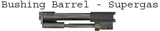

    Does anyone have any experience with this barrel?

                I recently purchased a used, blue carbon steel, Springfield Armory Trophy Match from one of the local gun shops with the intent of possibly getting back into competition shooting. It came with one of these barrels already in it. I am going to give it a work out on Monday. The one thing about the design I do not care for is I can't use my favorite lead 200 grain SWC load due to the gas port. There is an insert the breech face that lowered the firirng pin to hit the center of the primer since this barrel does not have the top locking lugs like a traditional 1911 barrel.

                  I recently purchased a used blue carbon steel Springfield Armory Trophy Match from one of the local gun shops with the intent of possibly getting back into competition shooting. It came with one of these barrels already in it. I am going to give it a work out on Monday. The one thing about the design I do not care for is I can't use my favorite lead 200 grain SWC load due to the gas port. There is an insert the breech face that lowered the firirng pin to hit the center of the primer since this barrel does not have the top locking lugs like a traditional 1911 barrel.

                    Range report. In my opinion this conversion is a POS. It was very accurate when it worked. Out of almost 300 rounds I was able to shoot one magazine with out multiple stoppages including failure to chamber and stove pipe jams. The only saving grace was the Trophy Match came with the original barrel which is now back in the gun. Magazines used were Les Baer, Wilson Combat and Metalform. Ammo was 230 grain XTPs, 6.2 grains of VV N340, OAL 1.225. The loads woked fine in my Colt and a buddies Springfield Mil-Spec.

                        After my dismal performance with the gas barrel I decided to put the factory barrel back in it. I took it out yesterday and fired 8 rounds throuh it. Three out of the 8 required a second hammer strike to fire. This did not instill confidence. Upon inspecting the brass the firing pin strikes were at the very bottom of the primers. The conversion process for the gas barrel required lowering the firing pin.
                        I ended up replacing the slide. Good bye pretty Trophy Match slide with adjustable sights and hello GI style, loose and tiny sights. It is back in the safe until I have time to see if it is reliable.
