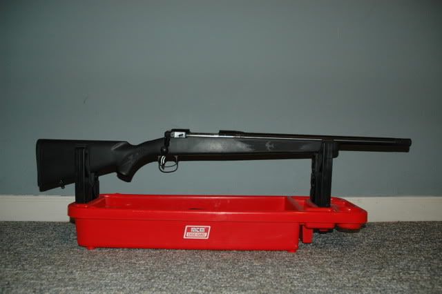

      Picked it up today...finally. It chambers a live factory round fine, tried a fired, non-resized case and it was a no go, not a fair test as the case was a no go in my other .223 bolt as well. We'll see how it does at extracting a case when I fire it.
      No tool marks on the barrel nut, or anything else, so that's good.
      I love the way it looks and feels! Much more balanced with 7.5" off of the heavy barrel!
      The factory stock is great, but flexes too much up front with a bipod on.

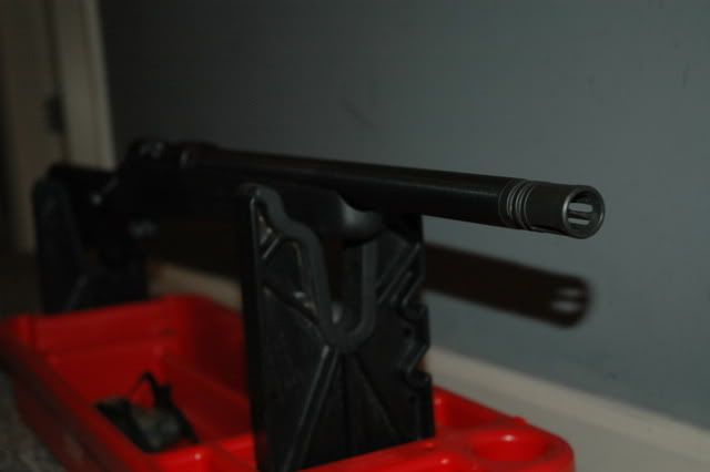

      Gonna make a different flash hider though. This one is off of an AR, and is slightly smaller in diameter that the end of the barrel...looks funny.

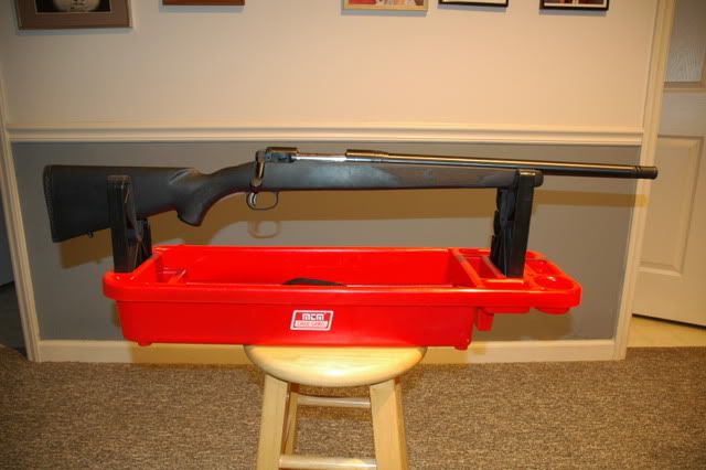

          Me too! The big test is still to come. According to him...it should be on the snug side if anything. He said to pay attention to how the round extracts, and if it's too difficult, bring it back. If I do that...and he still only has a "field" guage...all he'll do is back it out a bit. I think I'll order the gauges and tools and be ready to do that mayself...I have other Savage rifles so they'll come in handy.
          Here's a better pick with no shadow lines that make it look like an O/U:)
