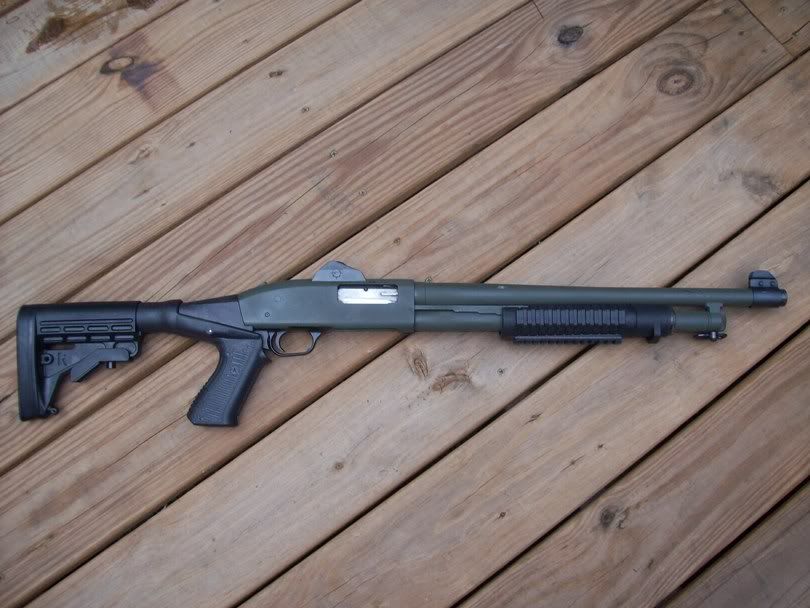

  • slowz1k
    replied
    They are from MMC. Ghost ring rear... Banded front with tritium insert. Awesome sights but I would think twice about buying from this company again. It took months to get the sights and only after almost daily phone calls, and threats of reporting them to the BBB. If I had to do it all over again, I'd go with the Mossberg ghost rings, and an XS tritium insert. Heres a link to MMC.... Beware.
