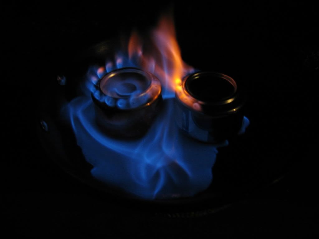

      Will do. Give me time to finish supper and get the wife out of the kitchen and I'll light 'em up! She might not like seeing me pour HEET in her frying pan to "kick 'em off"! :eek:

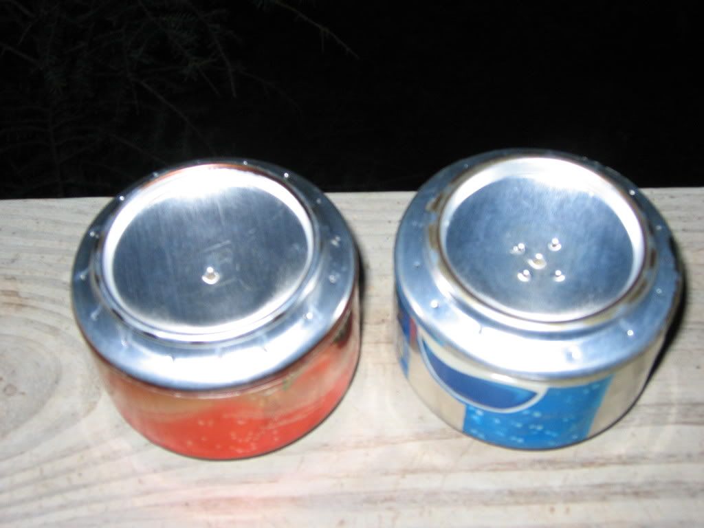

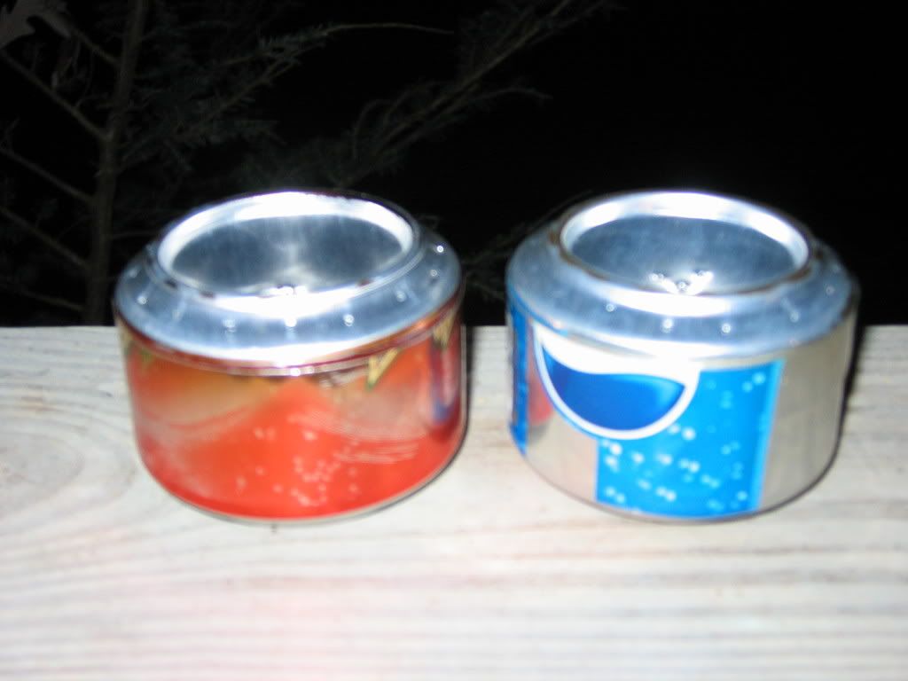

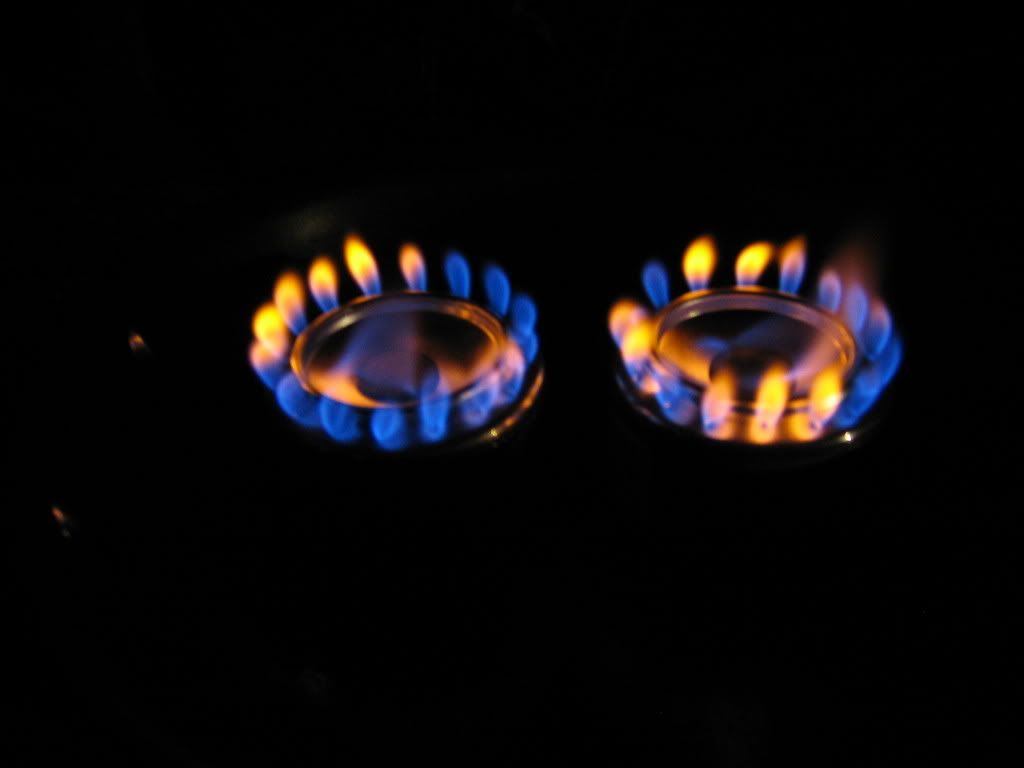

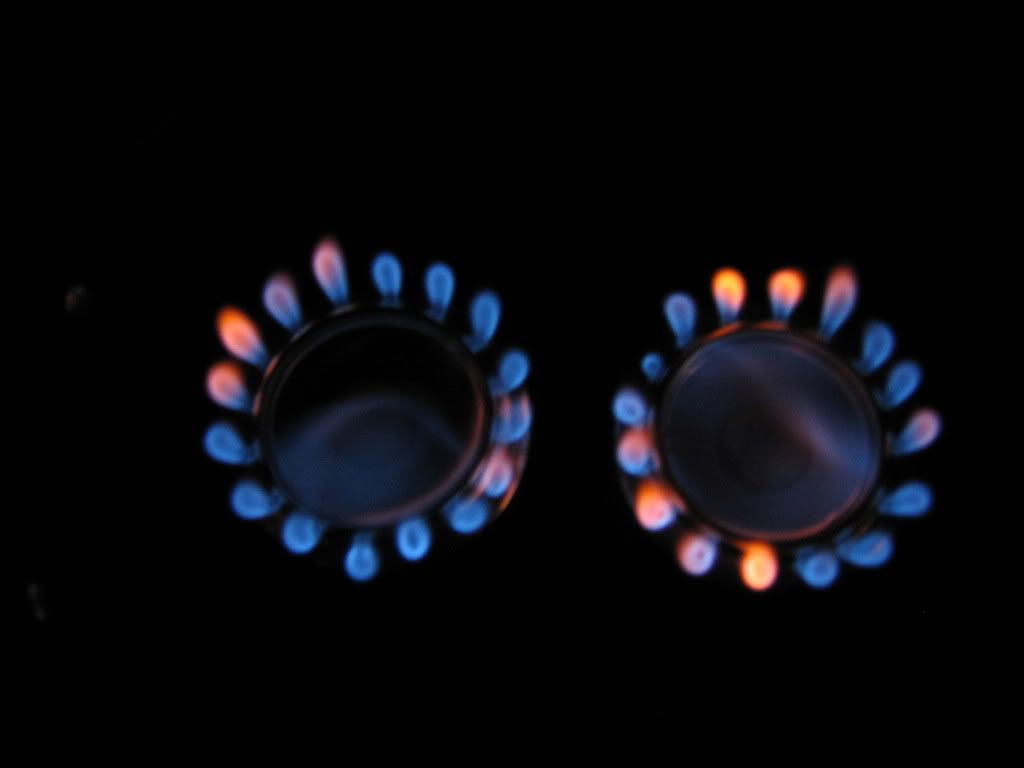

          Camera had trouble focusing in the dark, but you get the idea. I cut them by rotating the cans against a blade mounted to a 2x4, so the stoves are 1.5" high.

              How many holed do you punch in the middle? Great photos by the way. Gonna run to the auto parts store and get some Heet. They are 2 for a dollar down the road.

                  I put one hole in one of them and five in the other. The one hole is fine. It's just to pour the fuel in and then you have to close it up. I used a coin to seal it and it didn't work to well. I'd suggest one hole and use a screw to seal it. Will try that tomorrow. 2 for a dollar? Where? I paid $2 for a bottle today at Advance Auto Parts.
